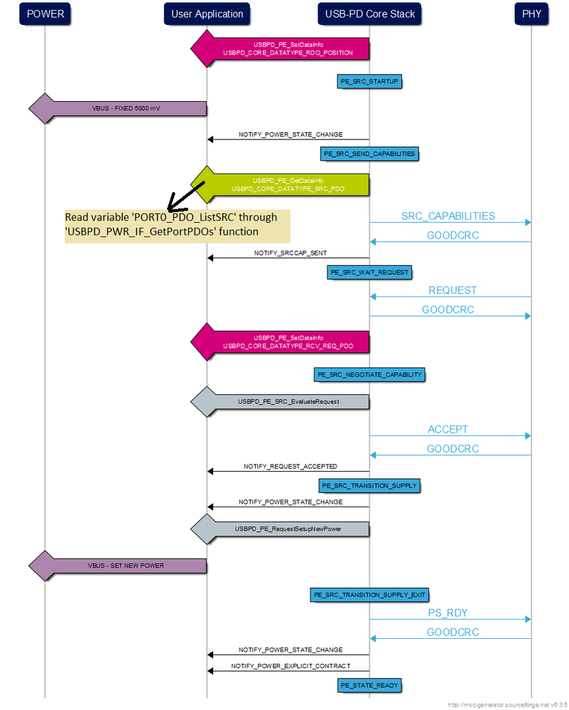

2020-08-31 2:17 AM
Dear @HGorl.1 ,
Power negociation follows the AMS described in UM2552 in 'Figure 24. SRC power negotiation':
You should update your function ''
* @brief Allow PDO data reading from PWR_IF storage.
* @param PortNum Port number
* @param DataId Type of data to be read from PWR_IF
* This parameter can be one of the following values:
* @arg @ref USBPD_CORE_DATATYPE_SRC_PDO Source PDO reading requested
* @arg @ref USBPD_CORE_DATATYPE_SNK_PDO Sink PDO reading requested
* @param Ptr Pointer on address where PDO values should be written (u8 pointer)
* @param Size Pointer on nb of u32 written by PWR_IF (nb of PDOs)
* @retval None
void USBPD_PWR_IF_GetPortPDOs(uint8_t PortNum, USBPD_CORE_DataInfoType_TypeDef DataId, uint8_t *Ptr, uint32_t *Size)
if (DataId == USBPD_CORE_DATATYPE_SRC_PDO)
*Size = PORT0_NB_SOURCEPDO;
memcpy(Ptr,PORT0_PDO_ListSRC, sizeof(uint32_t) * PORT0_NB_SOURCEPDO);
/* USER CODE BEGIN USBPD_PWR_IF_GetPortPDOs */
*Size = 0;
switch(DataId)
case USBPD_CORE_DATATYPE_SRC_PDO :
break;
default :
break;
/* USER CODE END USBPD_PWR_IF_GetPortPDOs */
}If you want to have more details, you can refer to the demonstration code available under:

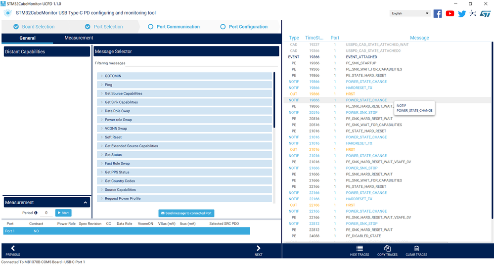

2020-09-01 3:01 AM
Hi Yohann,
It's really good to here from you. Thank you very much for Your reply.
Please have a look at the picture attached below. This when Discovery kit from ST attached to custom board after programming. (Note : we are working to Develop code from USB-PD_Provider_1port & code changes suggested in previous disscussion have been made, even though thing not working properly)
Please have a look at the files by going through the link:
https://drive.google.com/drive/folders/1enntGvObHZ_xGk3DRsqFqliGJxErmrvz?usp=sharing
Thanks & Regards
-Himavanth

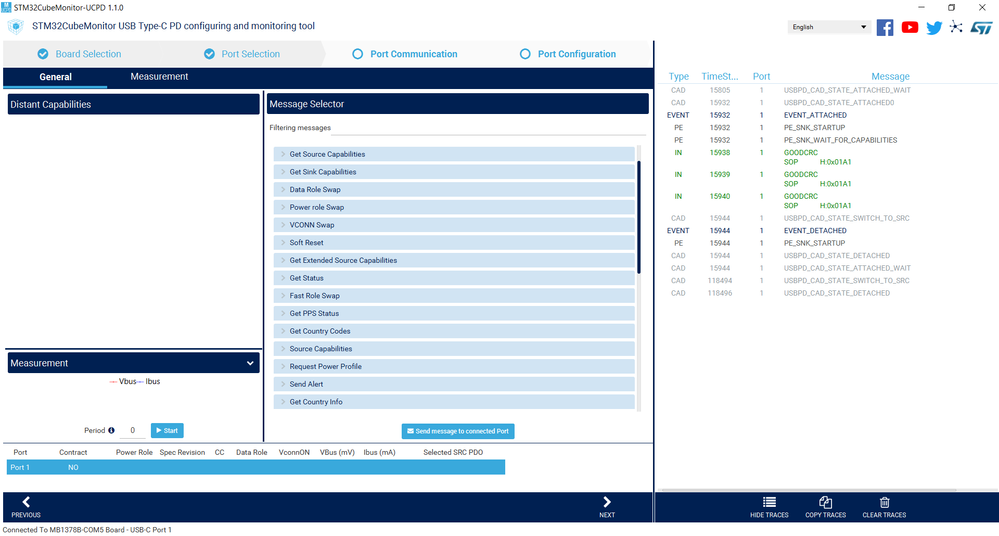

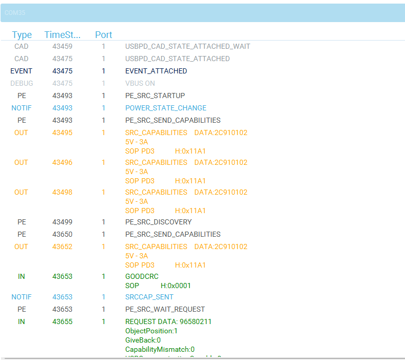

2020-09-02 5:02 AM
Hi Yohann,
Thank you for the reply.
I made few code changes suggested by you. Sorry I can't provide TRACER_EMB facility as we are using SWD debugger instead of JTAG debuggers.
I found JTAG debug facility is necessary for USBPD debug trace so I can't provide you the source side trace.
please have a look at the responds when I connected STM32G071B-DISCO in stand alone mode.
Note: Trace is from Sink device( STM32G071B-DISCO )attached to our Custom board.
Even after the code changes I couldn't find the source capabilities but I am getting the GoodCRC. I have gone through the wiki link provided by you I found few information relating to previous suggestion made by you.
Please Do have patience to have a look at debugging observation after cable connection:
Thanks & Regards
