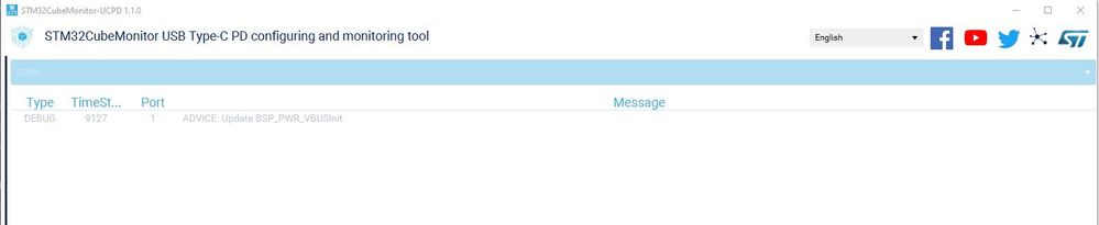

However, once running, the trace shows only this when I plug in a USB-C source:
From the example video, it should be showing many traces of USB-C PD messaging etc.
Looking at the code, there's several functions in usbpd_pwr_user.c alongside this BSP_PWR_VBUSInit function that are empty (aside from a trace call to tell you so), but the example never shows these being populated.
Am I missing something, is there any examples of what should be put in these functions to get the basic functionality working as shown in the demo?

In any case, I have found that the issue is around the GUI - when I disable the GUI, the trace messages all seem to work fine, but with the GUI enabled, it shows only that one trace message I showed in my image. As well as this, the GUI does not seem to work and I cannot see the board in the list of attached boards.

Thanks Ravi - yep I have done this, no change to functionality but I believe that it was the GUI causing my lack of trace messages - when disabled I can see PD negotiation happening. Thanks again.
