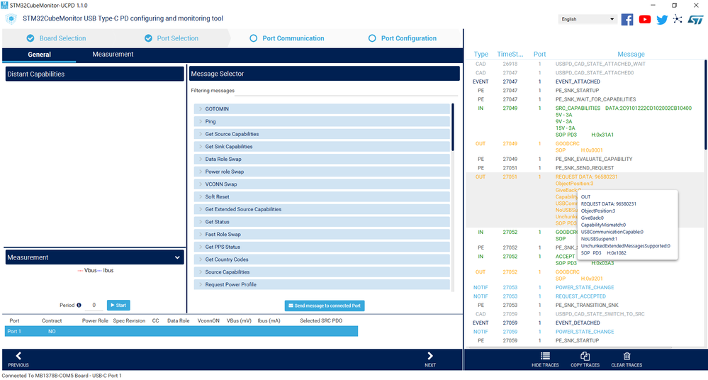

Thank you very much for your reply..... your reply helps us a lot.
please have a look at the sink trace when connected to source... seams to be everything proper(only need few changes to manage Power management part.).

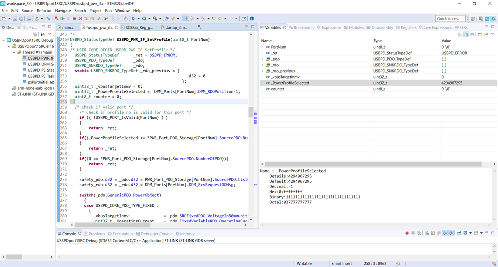

Hi Yohann,
please have a look at the fallowing.
if((_PowerProfileSelected >= *PWR_Port_PDO_Storage[PortNum].SourcePDO.NumberOfPDO))
return _ret;
if((0 == *PWR_Port_PDO_Storage[PortNum].SourcePDO.NumberOfPDO)){
return _ret;
}after a lot of time spending in Debugging device I found _PowerProfileSelected initialized with DPM_Ports[PortNum].DPM_RDOPosition is always 0(which shouldn't be).
I feel DPM_Ports[PortNum].DPM_RDOPosition should be updated after each negotiation... please suggest me some code changes so that RDO position update each time after negotiation.
Thanks for your support in building and Initializing PDO's.
Thanks & regards
-Himavanth

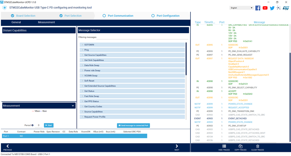

2020-09-07 8:39 AM
Here is my PD log after I connect Disco board.
2020-09-07 9:03 AM
PDO4 is requested (15V) but after transition to this voltage, we should received a PS_RDY message but a detach is detected by the device.
Could you confirm that you are able to switch correctly to 15V?
2020-09-07 10:58 AM
Yeah. I am able to get 15V properly. No issue at all.
As I am using different Feed back values(RA and RB values) in currently using board....I suspect I used RA and RB values comes with BSP board...if This is an issue with please confirm with Yes.
2020-09-07 11:10 PM
You can put a breakpoint in BSP_USBPD_PWR_VBUSGetVoltage and check the value of VBUS returned by this function.
