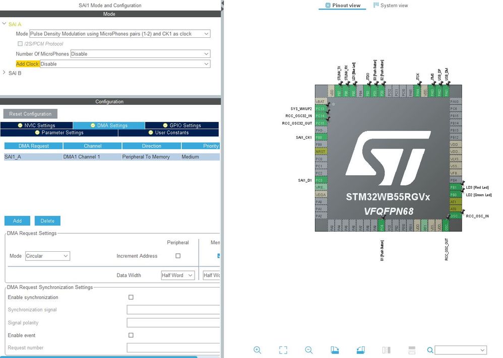

I try implement measuring sound level (SPL). I choose mic MP34DT05-A with PDM and connect to nucleo STM32WB55RG:
- data of mic connected to SAI_D1_PC3
- clock od mic connected to SAI1_CK1_PB8
- used the one mic so input of mic LR connected to GND (or VCC)

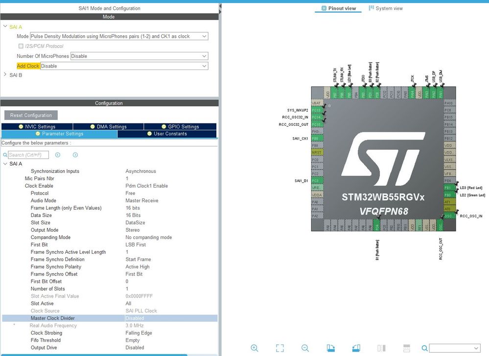

To generate code (setting of register) I used described example from section 4.3 of datasheet "Examples of configuration based on STM32CubeMX AN5027" and CubeMX.
and DMA:
Then I got two functions for the comprehensive PDM configuration:

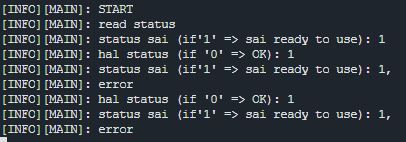

        uint8_t hal_status = HAL_SAI_Receive(&hsai_BlockA1, sound_in, 10, 1000);
        if (hal_status != HAL_OK)
            tr_info("hal status (if '0' => OK): %d", hal_status);
            tr_info("status sai (if'1' => sai ready to use): %d,", HAL_SAI_GetState(&hsai_BlockA1));
            Error_Handler();
        else
            tr_info("hal status OK");
            tr_info("data: %s", mbed_trace_array(hsai_BlockA1.pBuffPtr, 10));
            tr_info("sound in %s", mbed_trace_array(sound_in, sound_len));
To read mic data I used function:
but it recive error status HAL_ERROR
In mbed I don't change the clock setting so that may generate the error - I need connect clock to SAI periferia. Mbed doesn't give API to re-configure that - I don't want to do it on my own.
Or I made a configuration error.
someone can help me? I just need only read sound level not record or stream it anywhere.
