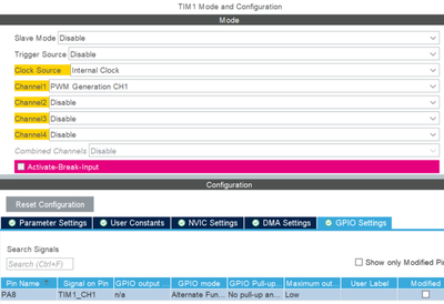

I'm working on a STM32F429I-Discovery board and trying to output a 24 MHz PWM signal on PA8 (TIM1_CH1) to drive an MT9M001 camera module as the XCLK signal.
In my own CubeMX-generated project, PA8 stays LOW — no waveform appears.
However, if I take the official example
Projects/STM324x9I_EVAL/Examples/DCMI/DCMI_CaptureMode,
and add the same PWM settings, the signal comes out fine.
Here’s what I confirmed:
TIM1 initialized successfully with HAL_TIM_PWM_Init() and HAL_TIM_PWM_ConfigChannel().
GPIO A8 = AF1_TIM1, Push-Pull, No Pull, Very High Speed.
HAL_TIM_PWM_Start(&htim1, TIM_CHANNEL_1); is executed.
PWM period = 7 (≈ 22.5 MHz), pulse = 4 (≈ 50 % duty).
System clock = 180 MHz (PLL on HSE 8 MHz).
No error occurs, but no output.
Thanks for any advice!

2025-11-10 6:16 AM
> sConfigOC.Pulse = 0;
You have configured a 0 % duty cycle wave--a DC signal. Change this to 4 if you want 50% duty cycle.
2025-11-10 3:36 AM
Better to post your project at least your ioc file.
I don't see why are you posting system_stm32f4xx.c content?

This is the TIM1 Mode and Configuration screen.
I can’t change “Maximum Output Speed”.
I tried:
Changing the pin to GPIO Output mode and setting it to Very High speed
Switching it back to TIM1 configuration
…but it always resets to the previous state.
Also, this parameter is not editable on the TIM1 configuration screen itself.
