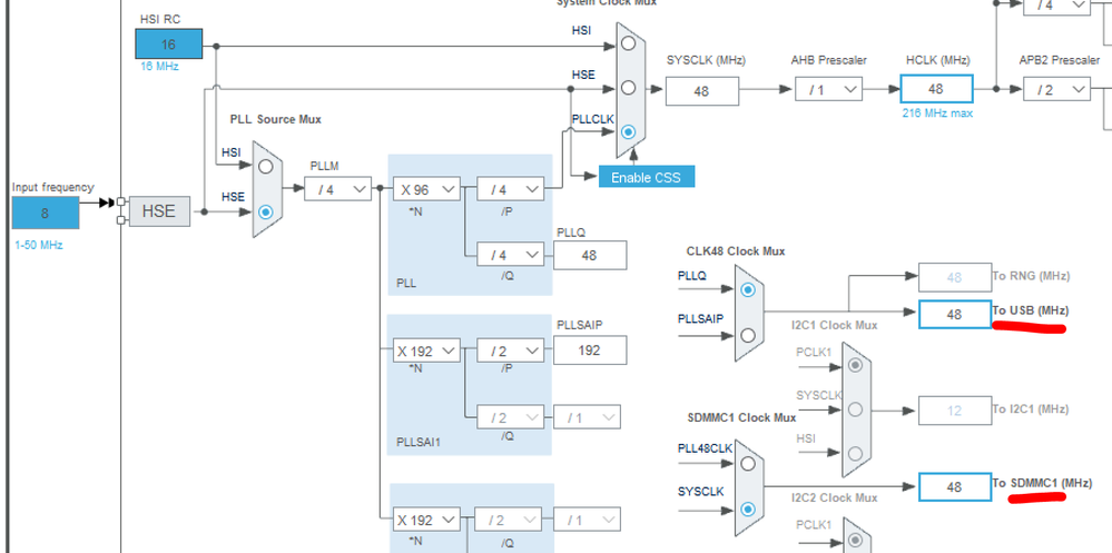

I tried to create a combination of USB MSC Device and uSD card with SDMMCx interface. The clock for USB was config at 48MHz and also for SDMMC.
In the examples that I saw online, one indicate the SDMMC clock need to be configured at 12MHz so it will match with USB 12Mbits/s for the Full Speed. Some other examples was use slower speed for the SDMMC interface.
If I am playing around with SDMMCCLK clock divide factor, like 2, 3, 4, (2 would be idea because 48Mhz/(2+2) = 12MHz, my eval board only show USB mass storage once I plugged in the USB to the PC, but there is no action like asking for format the device, and time out in couple minutes later.
Playing with this divide factor can made thing worst like the eval couldn't enumerate at all.
Please let me know if there is any correct clock setting for SDMMCx clock and the divide factor?

There's no need to reduce SDMMC to match 12 MHz. However, having a faster clock can expose bugs in the HAL implementation.
USB clock comes from PLLQ or PLLSAIP. CubeMX clock tree is useful for visualizing clocks. See CK48MSEL bit in RCC->DCKCFGR2.

Thank you for your reply. I have used the clock to configure the clocks exactly in your picture.
From this info
SDMMCCLK clock divide factor must be between 0 and 255.
Parameter Description:
SDMMC_CK = SDMMCCLK / [CLKDIV + 2]. The output clock frequency can vary between 187 KHz and 24 MHz. It is advised to keep the default ClockDiv value (0) to have a maximum SDMMC_CK frequency of 24 MHz.
So if SDMMC1 currently is configured as 48MHz in the clock tree, after the configuration, it will be 24MHz, and if I can adjust the SYSCLK to turn it down to 24MHz, will it become 12MHz?
Ideally SDMMC1 must have the faster speed to USB MSC FS right?
2021-06-23 7:51 PM
Yes.
Also, the fastest SDMMC clock is 48MHz and can be achieved by enabling the clock divider bypass.
Faster is generally better, but there's no link between the two.
