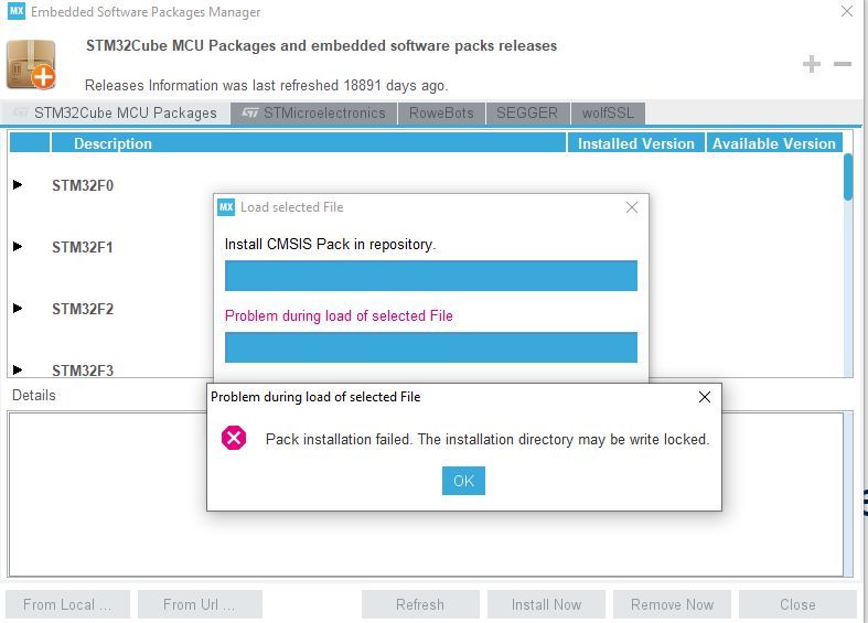

I keep getting the message "Pack Installation Failed. The installation directory may be write locked."
I have full administration on the PC (Win 10) and plenty of space, so...??
Appreciate some advice.

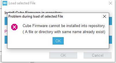

I have the same Issue and can not solve it. It is impossible to install the packages I get this error:
This is the message for the second package:
This is the error for the first package

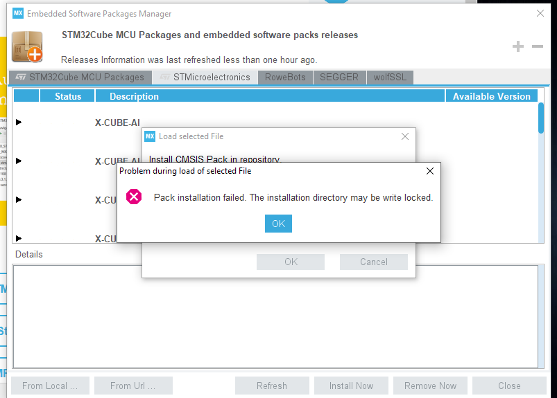

2021-09-21 5:18 AM
I solved it by copying the packages by hand into the folder
C:\Users\USERNAME\STM32Cube\Repository\Packs\STMicroelectronics
Also I disconnectet the computer from our office net and connectet it directly to an internet router.
