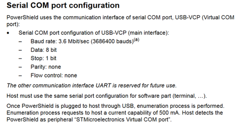

Here are the settings I use:

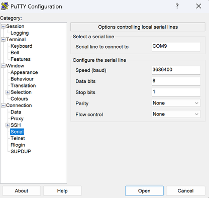

Show a screenshot of your PuTTY settings - are you sure it supports that baud rate?
2026-03-25 1:31 PM
Here are my settings.
I also tried with lower rates, but same issue.
The documentation mentions the following: "On host USB virtual COM port, configuration of baud rate may be not needed since replaced by USB maximum baudrate"

Your previous screenshot showed COM3; now you show COM9 - which is it ?
