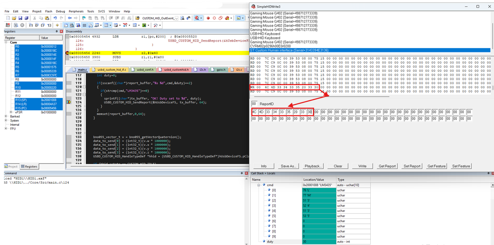

Hi Forum!

2026-04-21 6:14 PM
Hi
After some testing,
The problem is from function "USBD_CUSTOM_HID_DataOut()"
static uint8_t USBD_CUSTOM_HID_DataOut(...)
// ... callback after
return (uint8_t)USBD_OK;
// did not called, USBD_CUSTOM_HID_ReceivePacket()!
// OUT endpoint will not preprare to receive the new data
// the second data send from host, stm will lock in NAK
// SimpleHIDWrite timeout ->software crash
I found the problem that I forget to add this
static uint8_t USBD_CUSTOM_HID_DataOut(USBD_HandleTypeDef *pdev, uint8_t epnum)
UNUSED(epnum);
USBD_CUSTOM_HID_HandleTypeDef *hhid;
if (pdev->pClassDataCmsit[pdev->classId] == NULL)
return (uint8_t)USBD_FAIL;
hhid = (USBD_CUSTOM_HID_HandleTypeDef *)pdev->pClassDataCmsit[pdev->classId];
#ifdef USBD_CUSTOMHID_REPORT_BUFFER_EVENT_ENABLED
((USBD_CUSTOM_HID_ItfTypeDef *)pdev->pUserData[pdev->classId])->OutEvent(hhid->Report_buf);
#else
((USBD_CUSTOM_HID_ItfTypeDef *)pdev->pUserData[pdev->classId])->OutEvent(hhid->Report_buf[0],
hhid->Report_buf[1]);
#endif
/* add this line */
(void)USBD_CUSTOM_HID_ReceivePacket(pdev);
1.This file is not in user code part (this is STM32 HAL middleware), if CUBEMX re-generate, these code will be overwritten.
2.After this step, I can receive and transmit the data from BNO055 to STM32 and get these data via USB HID.
the main part
/* USER CODE BEGIN WHILE */
while (1)
/* USER CODE END WHILE */
if (flag_rx == 1)
flag_rx = 0;
char cmd[16] = {0};
int duty = 0;
if (sscanf((char*)report_buffer, "%15s %d", cmd, &duty) == 2)
if (strcmp(cmd, "LM3435") == 0)
memset(tx_buffer, 0, 64);
snprintf((char*)tx_buffer, 64, "OK! Duty set to %d", duty);
HID_SafeSend(tx_buffer, 64);
memset(report_buffer, 0, 64);
bno055_vector_t v = bno055_getVectorQuaternion();
int32_t data_to_send[4];
data_to_send[0] = (int32_t)(v.w * 1000000);
data_to_send[1] = (int32_t)(v.x * 1000000);
data_to_send[2] = (int32_t)(v.y * 1000000);
data_to_send[3] = (int32_t)(v.z * 1000000);
memcpy(tx_buffer, data_to_send, 16);
HAL_GPIO_TogglePin(GPIOB,GPIO_PIN_0);//testing that if loop is still on-work or broken
HAL_Delay(10);
/* USER CODE END 3 */
/* USER CODE BEGIN 4 */
uint8_t HID_SafeSend(uint8_t *buf, uint16_t len)
USBD_CUSTOM_HID_HandleTypeDef *hhid =
(USBD_CUSTOM_HID_HandleTypeDef*)hUsbDeviceFS.pClassData;
uint32_t tick = HAL_GetTick();
while (hhid->state != CUSTOM_HID_IDLE)
if ((HAL_GetTick() - tick) > 10)
return USBD_FAIL; //
return USBD_CUSTOM_HID_SendReport(&hUsbDeviceFS, buf, len);
/* USER CODE END 4 */
Thank you
Best Regard Steve
