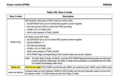

Hello @devfwtest
Wakeup from STOP3 mode cannot be performed by EXTI interrupt. You need to configure a wakeup pin as mentioned in the reference manual.
Please look at the example code below to set your wakeup pin :
/* Enable WKUP pin */
__HAL_RCC_PWR_CLK_ENABLE();
HAL_PWR_EnableWakeUpPin(PWR_WAKEUP_PIN2_HIGH_1);
__HAL_PWR_CLEAR_FLAG(PWR_WAKEUP_FLAG2);
