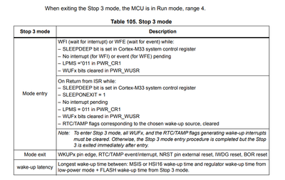

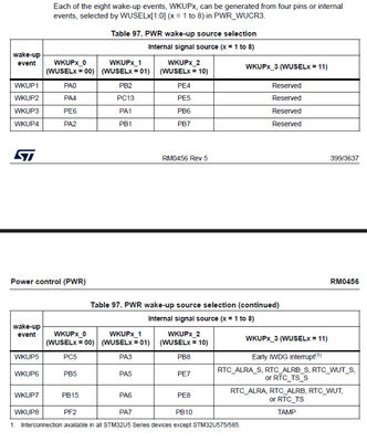

Check also the wakeup source selection :
According to the RM0456 (section: 10.7.9 Stop 3 mode), you can exit the STOP 3 mode using WKUPx pin edge, RTC/TAMP event/interrupt, NRST pin external reset, IWDG reset, BOR reset.
