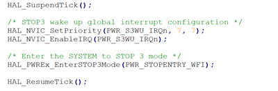

Please ensure that you suspend the SysTick interrupt before entering STOP mode as shown below:
With Regards,
2024-12-27 8:43 AM
SysTick is suspended and binary is generated from PWR_LPMODE_RTC example only, so it is already taken care in that example.
Thanks,
Mohan
