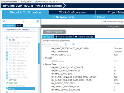

- There are few parameters named MediaBlockLength and LastLba. According to my understanding, I need to put
MediaBlockLength = 4096 and LastLba = (1024-1) = 1023.
- But I'm getting restricted (in terms of size of block) by other 2 parameters named UX_SLAVE_REQUEST_CONTROL_MAX_LENGTH and UX_SLAVE_REQUEST_DATA_MAX_LENGTH.
- Maximum value of MediaBlockLength is getting restricted by the value of UX_SLAVE_REQUEST_DATA_MAX_LENGTH. But the thing is, I'm not able to put the value of UX_SLAVE_REQUEST_DATA_MAX_LENGTH > 2048 i.e the device is not getting detected at all.
- And because the MediaBlockLength = 2KB, In the device manager, I'm getting the capacity of (D:) as 2MB. Like, if I put it as 1KB, it is showing 1MB.
- Also, maximum value of UX_SLAVE_REQUEST_CONTROL_MAX_LENGTH = 1024.

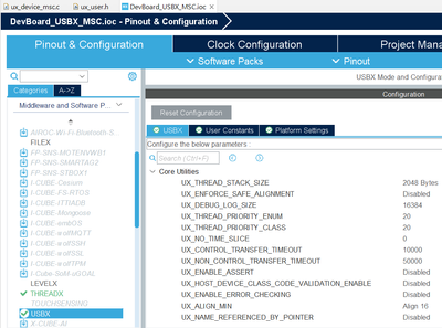

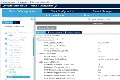

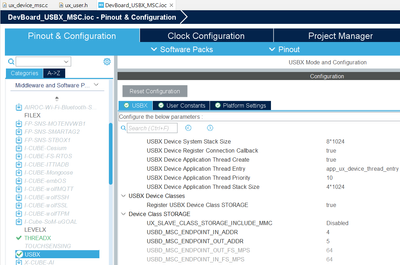

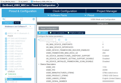

2025-07-30 11:12 PM
Hi @RB4020 what configuration ur using for ThreadX? and can u share ux_device.c file, and what clock configuration your ur using?
