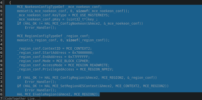

my mce configuration for the external memory init;

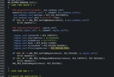

my mce configuration for the boot main

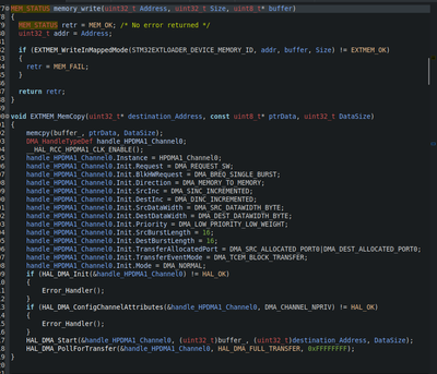

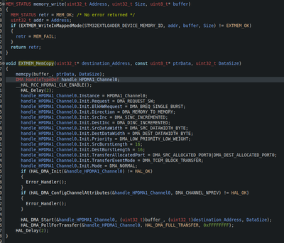

My memory write and memcopy methods;

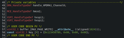

key and other variables

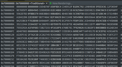

Decrypted result (wrong values, it must be start from ram base)

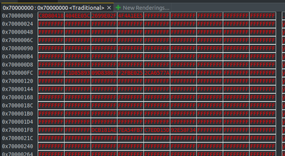

encripted file;

I tried to move the flash xspi2 -> xspi1 but it doesnt change anything in aes with mce1, and i closed the mce peripheral and i tried to write some things via these EXTMEM_MemCopy, memory_write but methods.

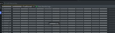

The methods defined as weak normally and the instuctor edited these codes for dma transfer mapped mode. (I added the codes as picture). But i saw only 0x00 at the flash when i use these methods. 
