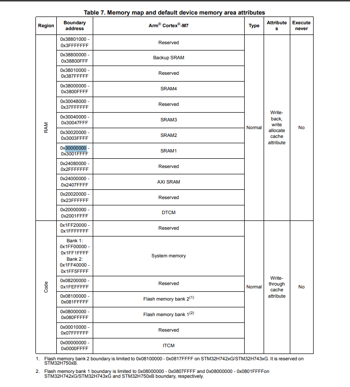

Check if you have issues with memory sharing between both USB and Ethernet. Did you study the memory split between both related software (USB and ETH)?

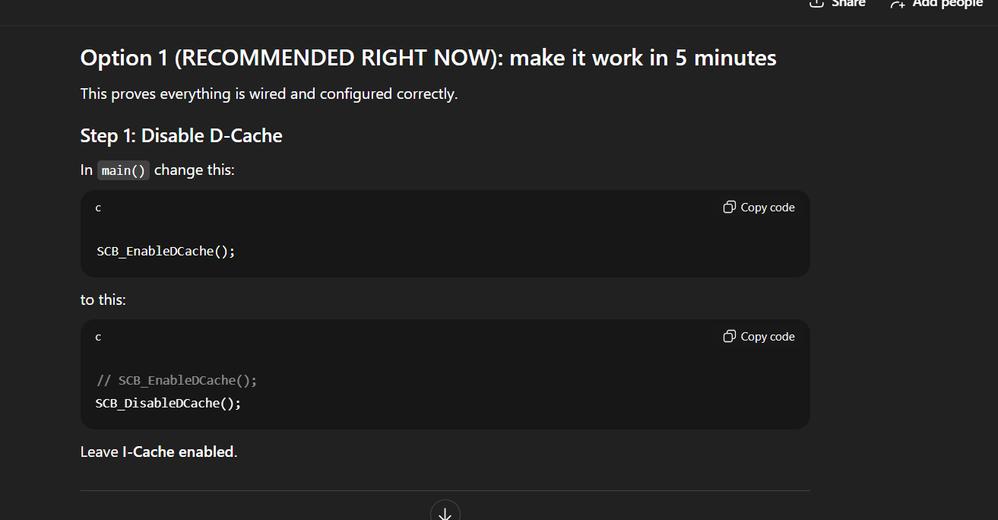

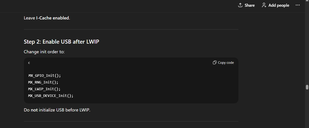

I am new to this ,what i want is to use ethernet and usb cdc to use simultaneously at a time without RTOS and i have tried with correct memory mappings but still not getting it
step 1 : i got a output when dcache is disabled and init() functions are in order: this is working 100%
but this is not a solution right?
so i tried with step2:by referring chatgpt but not getting and not able to ping it
