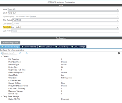

Is it possible to use two OSPI with below configuration. I can make this configuration in cubeMx but whiel debugging ospi1 is not working after ospi2 initialize.

Hello, my code was like (cubeMX created that)
sOspiManagerCfg.ClkPort = 1;
sOspiManagerCfg.NCSPort = 1;
sOspiManagerCfg.IOLowPort = HAL_OSPIM_IOPORT_1_LOW;
if (HAL_OSPIM_Config(&hospi1, &sOspiManagerCfg, HAL_OSPI_TIMEOUT_DEFAULT_VALUE) != HAL_OK)
Error_Handler();
sOspiManagerCfg.ClkPort = 2;
sOspiManagerCfg.NCSPort = 2;
sOspiManagerCfg.IOLowPort = HAL_OSPIM_IOPORT_1_HIGH;
if (HAL_OSPIM_Config(&hospi2, &sOspiManagerCfg, HAL_OSPI_TIMEOUT_DEFAULT_VALUE) != HAL_OK)
Error_Handler();
}I added only sOspiManagerCfg.IOHighPort = HAL_OSPIM_IOPORT_1_HIGH; to OSPI1 init like below
Error_Handler();
}and it works fine .

Hello @Epamuk ;
First of all thank you for sharing this behavior in the community.
Could you please look at this issue Solved: OCTOSPI: HAL_OSPIM_Config() - STMicroelectronics Community. I think you are experiencing the same issue.
To solve the issue could you please try to modify these code lines in octospi.c file
Error_Handler();
Error_Handler();
by
sOspiManagerCfg.DQSPort = 1;
Error_Handler();
sOspiManagerCfg.DQSPort = 2;
Error_Handler();
Please let me know if the issue is solved or not?
