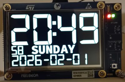

I did exactly now on this devboard RTC with additional functions like pictures slideshow and so on.
Maybe will be helpful the code of RTC project.
https://github.com/wegi1/STM32U5G9J-DK2-RTC
What is the most significancy in support at this board and many other Discovery kit, that is the Examples pack shared in CubeMX. How I try to programming this boards it is not like you perfection setup peripherial one by one, just I use and look at the examples and copy BSP libraries. For example when I "wake up" external flash, I used BSP files and additionally in CubeMX set HSPI as enable without any settings made. All of this doing for me 1 line invoking BSP function:
status = BSP_HSPI_NOR_Init(0, &Hspi_NOR_Init);And thats it. Whole function which read RAW data of picture into the frame buffer looks:

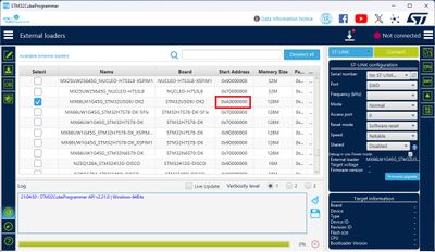

I'm not sure in this kit external flash can be mapped at 0x90000000 bcos external loader working at 0xA0000000:
