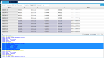

Further, if I load say 0x0F (or anything) using the CubeMX Prog, I can see it goes in (up to a certian point as I mentioned in myother post. If I then try and build and run from the the IDE, I get, as discussed, the error of verification failure, geting back 0.x00 instead of 0x0F, AND the SPI memory 9whcn checked witb the MXProg again s indeed now all wiped to 0x00.
Odd!
Any advice?
Thanks
Matt
2024-08-27 7:41 AM
Heres an odd thing: Using the CubeMX loader, (You can see in the console what a sked to be written) It seems to stop at 0x90010000 depsite me asking to write:
15:33:15 : Time elapsed during the read operation is: 00:02:29.775
15:35:57 : Filling memory operation:
15:35:57 : Start address : 0x90000000
15:35:57 : Size(Bytes) : 0x01000000
15:35:57 : Data value : 0x0000000F
15:35:57 : Filling data size(Bytes): 8 bits
15:35:57 : Erasing external memory sectors [0 255]
Is there an issue here?
