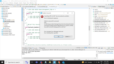

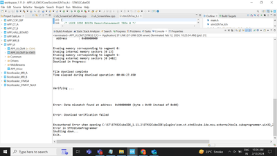

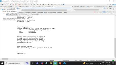

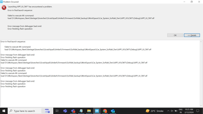

2024-02-11 10:00 PM
I am Using "Winboard 25Q512JVEQ" foe external memory .
Please Find Attached Snap shot while i am verify.
1) This Image is related to Verification start process
2) After Verification I am getting error message
4) Verifications failed console message

A data shift can be seen if the address width or dummy cycles are in disagreement. Repetitive nibbles would suggest the command is not supported in the current mode.
An illustration of what was written and what's read back would be instructive.
