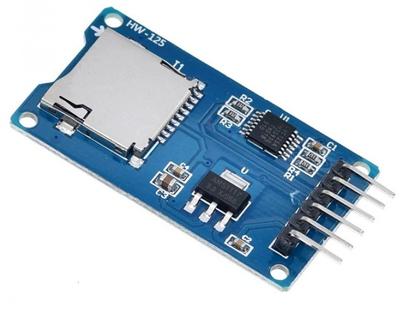

@demir wrote:HW125 SD CARD MODULE
Do you mean one of these?
Do you have a link to its datasheet?

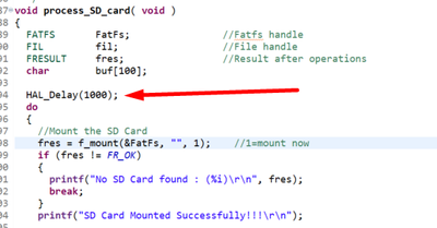

2024-02-19 6:37 AM
Hi @Andrew Neil
I came to know that SD Card needs some to settle. So, the only I have done is that, I added some delay before mountin the SD card as below. Hope it helps.
