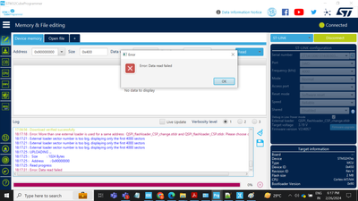

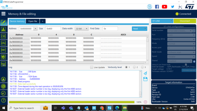

May i know are you talking about which hex.bin files
Right now i am getting this value on external address.
2024-02-16 2:59 AM
May i ask if you could use to write/read the code you have use with this Loader?
If you follow the STM32 video guide, or by your own, when you write the code for an external loader, one think you may do is to test that with the code before generating the EL you can write and read it back. I am asking you this because my guess is, the write operations is happening but not as intended. Thats my guess since your data, for me, has no sence, but maybe i am wrong and it does make sence for you.

Hi i have Debug My code with Testing code of in that i am getting right data but while i have loaded with CubeProgrammer i am getting following debug log and getting verification failed
my loader file memory defination is

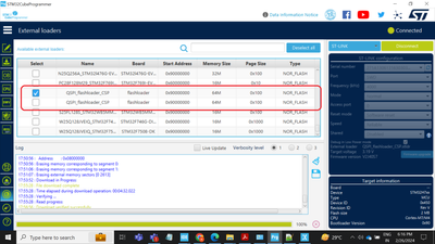

It appears that you've attempted to use various files from the GitHub repository you mentioned (https://github.com/cturvey/stm32extldr/tree/main/h7_w25q512), but i consistently encounter an "Erase failed" error. Upon examining the configurations available, it seems none matches your specific setup for QSPI.
Your QSPI configuration is as follows:
Although i found a configuration (h7_w25q256) similar to mine, i encountered the same "Flash Erase failed" error.
One notable observation is that the file sizes of the configurations are considerably smaller compared to my generated .stldr file.
This suggests that there might not be an appropriate configuration available for your specific setup.

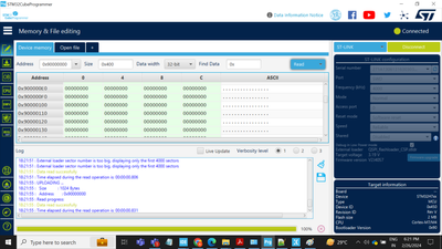

Certainly, I've noticed an interesting phenomenon while programming a device using STMCubeProgrammer for verification purposes.
Here's a step-by-step breakdown of the process:
2) Duplicate one of the .stldr files and attempt to read data from it. However, when selecting the address as 0x90000000, an error occurs.
3) Revert to the original file, reconnect the device, and successfully read data from address 0x90000000.
5.Reconnect the device again and initiate programming with the verification option checked, which is successful.
6.Subsequently, without making any changes or selections, attempt to program and verify again, and surprisingly, it verifies successfully without repeating steps 1 and 2.
Note: Initially, it's necessary to perform steps 1 and 2. However, after that, the verification process succeeds without needing to repeat those steps.
