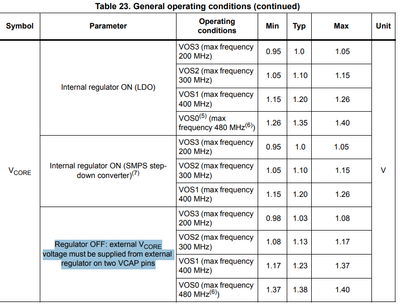

However, this seems to violate the power rail sequencing requirements of the STM32H745. I'm having a little trouble deriving the exact requirements from the datasheet and "Getting Started Guide" (AN4938), but the following excerpt makes me think that if I'm bypassing the internal LDO and driving Vcore externally, the Vcore rail must come up before the Vdd rail:

The minimum voltage for VDDLDO is in fact 1.62V → but this pertains to when you're leveraging the internal LDO to produce the Vcore rail.
In my configuration, I'm bypassing the internal LDO and directly driving the Vcap pin, which is internally tied to the Vcore rail. The Vcore rail, when driven externally, should be driven between 0.98V and 1.38V depending on what frequency you're running the core at.
