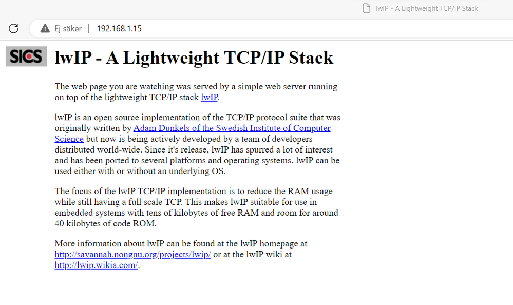

2023-01-03 11:38 AM
Yes. Now it's working.
I tried both with FreeRTOS and without FreeRTOS. With FreeRTOS, the connection was slow, or sometimes my webbserver did not responds. It was due to threads doing something else. Sometimes it works, sometimes not.
But without FreeRTOS. I just only need to write this code in main.c file

}And my webbserver host directly. I like it. So yes. it was the "const" datatype that causing this error.
By replacing Ethernet MAC onto RAM instead of FLASH. Is this a bug in STM32CubeIDE firmware for STM32F407 series?
Thank you so much.

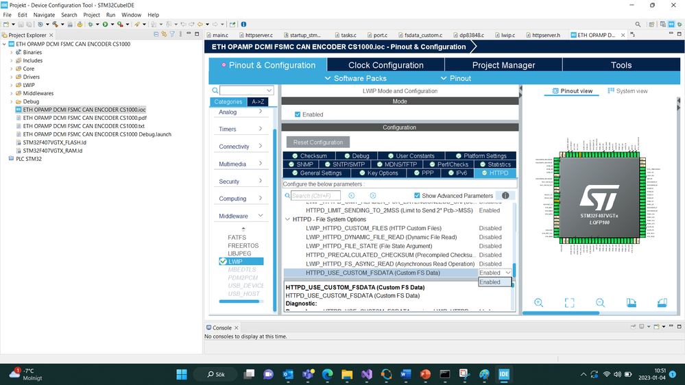

2023-01-04 1:53 AM
Great!
Also fix this. I can only select "fsdata_custom.c". Looking forward for Week 23 this year. Thank you so much :)
