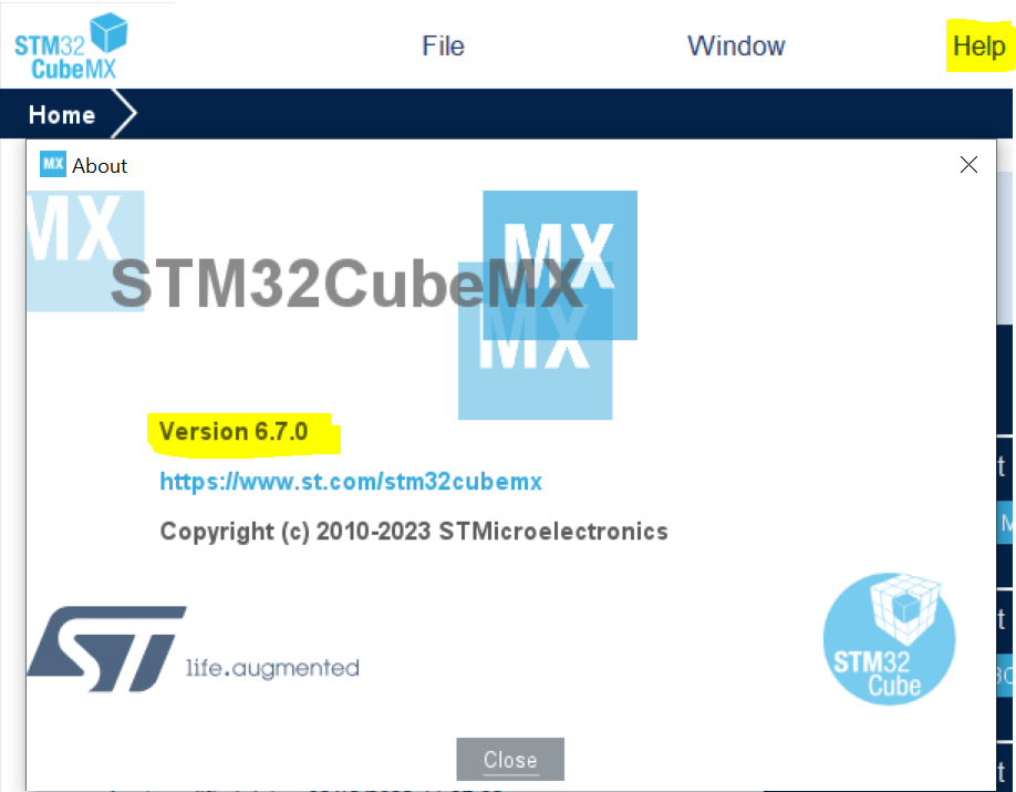

2023-01-02 6:58 AM
I'm asking about STM32CubeMX version (not STM32CubeIDE)
As mentioned below :
Go to STM32CubeMX --> help --> About
2023-01-02 7:01 AM
I don't have STM32CubeMX. Only STM32CubeIDE.
