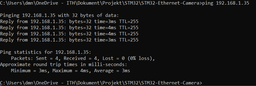

Recently I had problems with ping to my STM32 + LwIP + DP83848 + RMII. But the latest FW version 1.27.1, it works very well! But now I have problems with HTTP. Follow me and I show you how to create this bug.
First of all I'm using:
To reproduce this bug, do the following steps.
OK! It Working great!

So, do you have any suggestions why HTTP not working for me, but ping works?
2022-08-09 11:40 AM
Because of the issues listed in that topic! Until the lower layers are reliable, there is no point in wondering why higher layers don't work.
