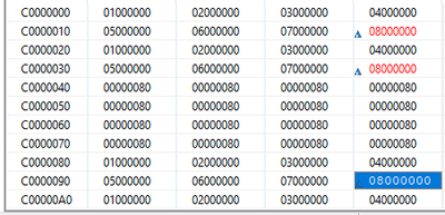

i can read/write the entire bank (64Mbytes) one word at a time, but then when I run a memory test, where it uses a pattern (incrementor) at each location the memory test fails. Also, in debug mode, when I step through the program and watch the memory window, i noticed weird things happening. Before this memory tests starts, the entire 64mb is initialized to x80000000 as shown below:
Now the first write happens to location 0xc000_0000 <= 0000_0001, which seem to write there, but it also writes or reads from addresses: C000_0020, C000_0080, C000_00A0

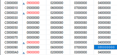

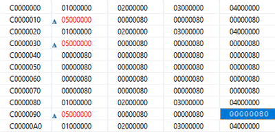

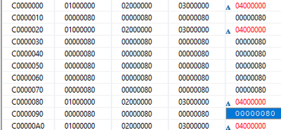

Something similar happens to the next memory locations:
etc... it does that through out the entire memory space. I checked the schematic, and all the address lines seem to be routed properly (and i was able to initialize the sdram), so I don't think it is that. I tried this memory test program on multiple boards, exact same issue on all.
