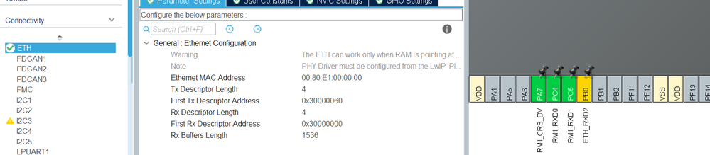

I tried initializing a simple lwIp project on cubeMx
Following the controllersTech's videos I :
From there I can generate the project.
I add "extern struct netif gnetif;" in the main and "ethernetif_input(&gnetif);" and "sys_check_timeouts();" to the super loop (while(1)).
I should now be able to build and run my program and ping the IP address but when debugging it I instantly get a hardfault.
When debugging using "step over", I notice that the programm/thread is stuck during "SCB_EnableDCache();"

I can see that the domaine 2 now have lwip_sec however it is only 192Kb (the descriptors but not the buffer) and I cannot click it in the memory details window to show what is inside (on the controllersTech video he can click on it to show what is inside).
I tried using the cubeMx files from the github repo mentionned earlier
The github repo seems to have everything working well.
Since I cannot specify the buffer memory address I looked at his cubeMx file.
It uses an older version of cubeMx so I had the choice to continue or to migrate, I tried both and migrate worked.
Indeed his cubeMx file is different than mine: in ETH, he can specify the memory address of the buffer! (at the time I am writting that i cannot reproduce this but I clearly remember it)
The rest of the setup is similar.

4) Do you know why I cannot set the memory address of the buffer in cubeMx?
