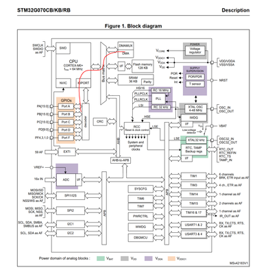

In 'G0, GPIO are connected to the cpu-private IOPORT bus, not accessible from the rest of the chip, i.e. DMA cannot access GPIO in 'G0.
2025-07-22 3:20 AM
Thank you very much.
Writing to BSRR or BRR register is also impossible?
2025-07-22 4:57 AM
DMA on GPIO must be possible following datasheet of the controller

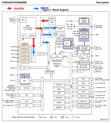

2025-07-22 5:14 AM - edited 2025-07-22 5:17 AM
No that path is not possible.
That diagram is simplified in the fact, that the matrix consists of masters and slaves. Only master can initiate a transfer, providing address and direction of transfer and actively produce/consume data; and only slave can passively "consume" or "produce" the data of that transfer according to the address and direction provided by master. In other words, while the double-ended arrows do indicate the bi-directional flow of data, they don't correctly indicate the unidirectinal flow of address and control.
