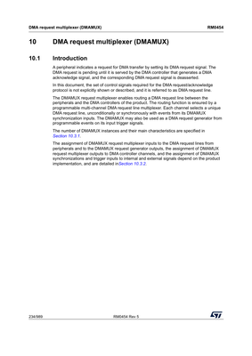

2025-08-27 8:42 AM
Read out and check/post content of TIM, ADC, DMAMUX and DMA registers.
2025-08-27 8:45 AM
I didn't get you. I have already shared Initialization code in chat.

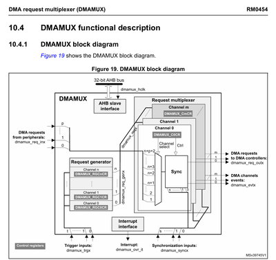

2025-08-27 9:12 AM
The DMAMUX needs to be configured to tie the ADC to that DMA channel.
2025-08-27 9:14 AM
share the snippet if possible.
2025-08-27 9:15 AM - edited 2025-08-27 9:22 AM
Can you share the example?already doing this part. n STM32G070 (G0x0) there is no DMAMUX, and there’s nothing to tie.
The ADC to DMA mapping is fixed in hardware: ADC1 → DMA1 Channel 1.

2025-08-27 9:25 AM - edited 2025-08-27 9:27 AM
The mcu works out of the registers content rather than source code. There may be e.g. errors in the library you are using.
Where do you have this information from, AI?
Have you had a look at the Reference Manual?
As TDK said, you need to set DMAMUX channel related to the DMA channel you are using, the numbering does not match so it's DMAMUX channel 0. At the beginning of DMAMUX chapter you'll see the table of triggers, so enter the number related to given ADC to DMAMUX_CxCR.DMAREQ_ID, that's all. There certainly are LL functions and defines for these things, you can find them in Cube, which is open source.
Or maybe TDK will provide you with ready made solution, but do you want to rely on that?
Did AI tell you that? The Reference Manual says it's there. See the "Request Generator" part.
Here's a working example:
