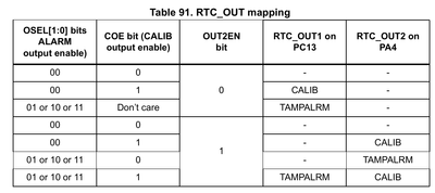

PA4 also has an RTC_OUT_CALIB functionality. Probably there is some issue that RTC takes over the pin when calibration is enabled.
Is this from CubeMX-generated code? Can you share your IOC file?
Edit:
Ensure OUT2EN=0.
2026-02-06 5:44 AM
Hello TDK,
thanks for the reply. Unfortunately, we are not using the Cube-Code, so there is no valid IOC to share. For testing, I set OUT2EN=1. This makes PA4 the calibration pin, with 512Hz output. I measured it, this works fine.
With OUT2EN=0, I have the described problem.
