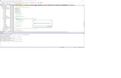

2025-07-24 1:30 AM
@Ashish1 wrote:I encounter an "INTERNAL PARAMETER ERROR" when attempting to flash the Cortex-M4 (CM4) core.
Where, exactly, do you encounter that?
Please show a screenshot.
If it's in Keil, then "INTERNAL" suggests something internal to Keil - so you should ask Keil (ie, ARM) about that:

2025-07-24 1:59 AM
2025-07-24 1:59 AM
find the attachment

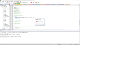

2025-07-24 2:10 AM
Please see the link on how to capture screenshots - in particular, selecting just part of the screen:
So the actual message is:
Which is, indeed, something internal to Keil - so nothing to do with ST.
Therefore you need to ask Keil (ie, ARM) about that.
