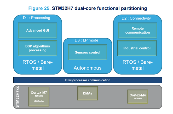

Not possible to answer all of your questions and propose an exhaustive answer. But my proposal why don't you scale up the STM32 by using a more performant MCU such as STM32H7. STM32H7 dual core (Ex: STM32H745) can be a good candidate for your application. It can reach up to 480MHz of system clock in LDO mode at VOS0.
And the partitioning of your application will be as the following:
CM7 is controlling the motors / Graphics if available
CM4 is managing the sensors and external communication: FDCAN, USARTs, RS485 etc ..
Please refer to the application note AN5557 "STM32H745/755 and STM32H747/757 lines dual-core architecture" / especially the section 4. Application partitioning examples.
The figure from that application note:
Hope that I've provided an idea on how to proceed.
Good luck.
