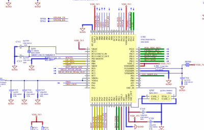

If you can check anything, there is schematic:

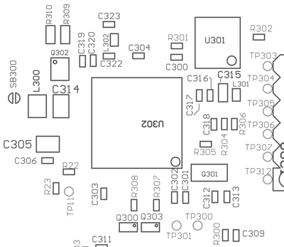

I do not have PCB layout now, but only this:
If anything could be wrong, please let me know. Thank you very much.
