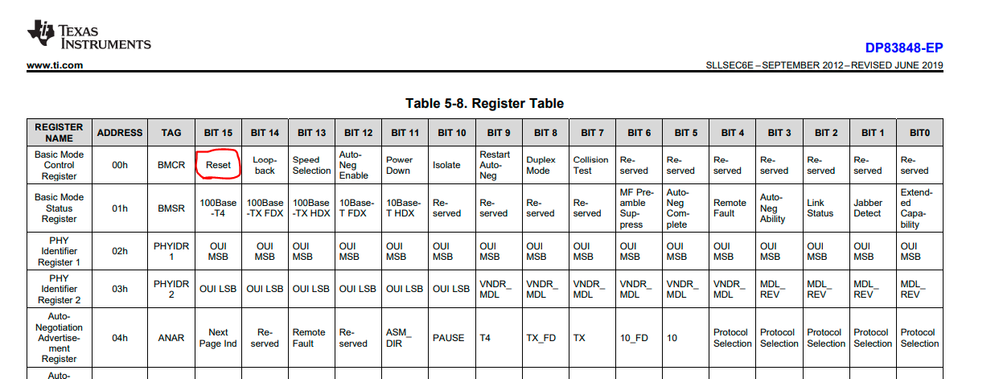

@Pavel A.
@Piranha
I found an issue now. This function calls with DevAddr = 0x1, RegAddr = 0x0 and RegVal = 0x8000 which means that RESET is called. That's correct. But this function ONLY calls at the start of the ST-controller. Otherwise...the function is not called any more during the run.
* @brief Write a value to a PHY register through the MDIO interface.
* @param DevAddr: PHY port address
* @param RegAddr: PHY register address
* @param RegVal: Value to be written
* @retval 0 if OK -1 if Error
int32_t ETH_PHY_IO_WriteReg(uint32_t DevAddr, uint32_t RegAddr, uint32_t RegVal)
if(HAL_ETH_WritePHYRegister(&heth, DevAddr, RegAddr, RegVal) != HAL_OK)
return -1;
return 0;
