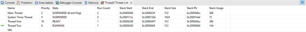

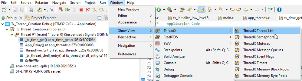

after starting the debugger you can access the ThreadX list as shown below:
notice that you need to pause the debugger to see updated infos, they are not update on runtime.
Hope this helps.
