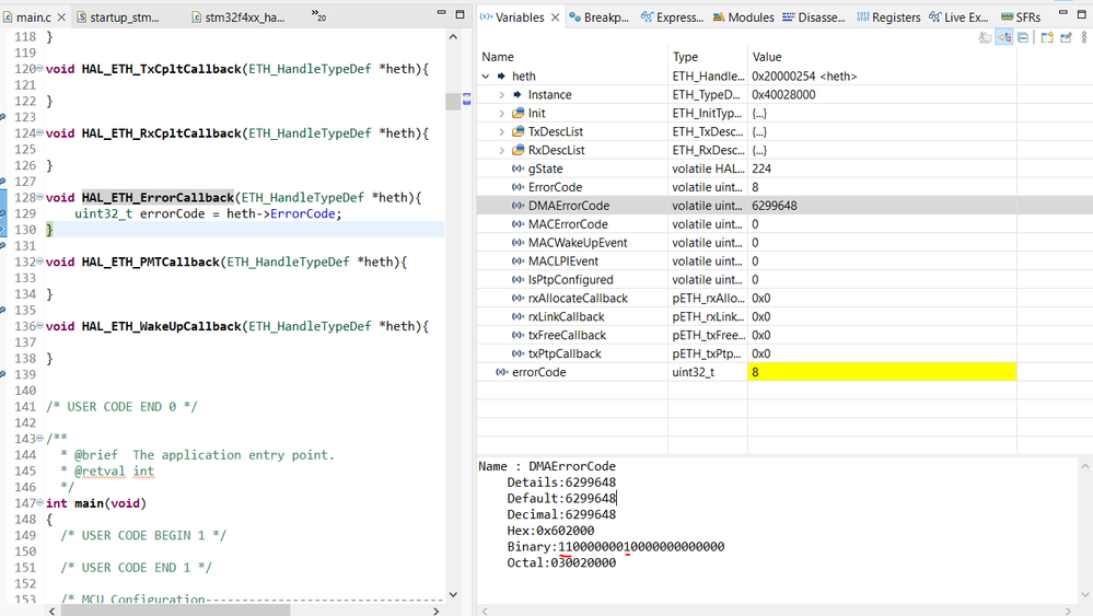

I found a bug when I enabling the ETH perpherial in the STM32F407 processor. The error is a DMA bus error.
What's happening:
It occurs when the ethernet PHY recieve a message from my router.
How to produce the error:
I do the following steps to reproduce the error.
Then this call back function HAL_ETH_ErrorCallback(ETH_HandleTypeDef *heth); will be called.
The error code is a DMA error.

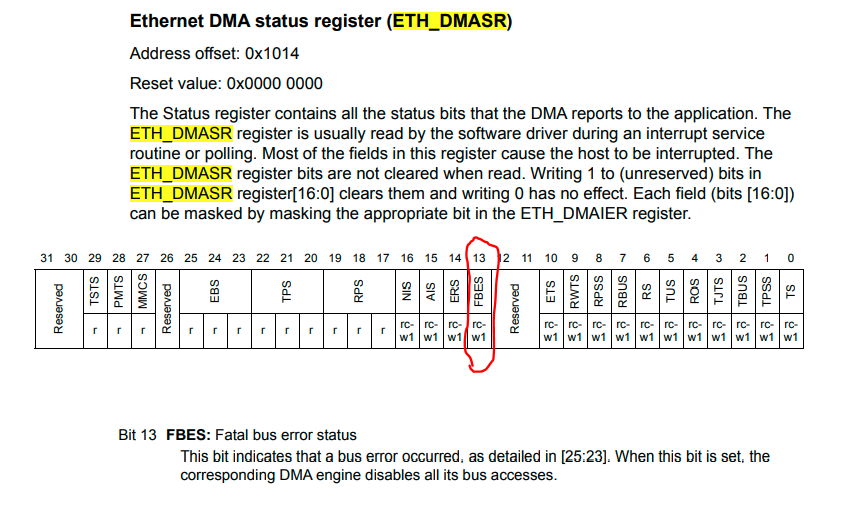

*/The DMA error is a DMA bus error.

if (__HAL_ETH_DMA_GET_IT(heth, ETH_DMASR_FBES))
/* Get DMA error code */
heth->DMAErrorCode = READ_BIT(heth->Instance->DMASR, (ETH_DMASR_FBES | ETH_DMASR_TPS | ETH_DMASR_RPS)); <<--- HERE!

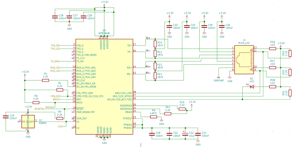

The hardware settings are for RMII for the Ethernet PHY DP83848 .
Yes! The LED D1 flashes when something happen at the network. The pin ACT_LED/COL should go low when something happens. The oscillator is at 50 MHz and very close to the DP83848 chip.

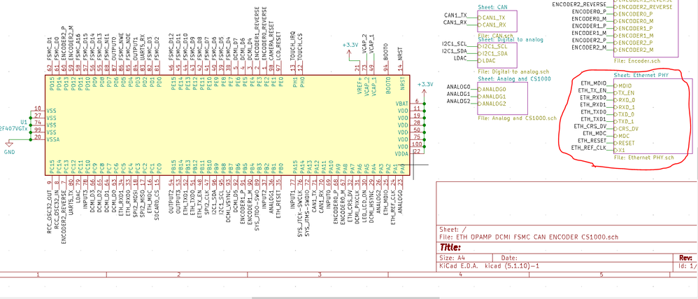

STM32 project:
Schematic project (KiCAD):

What am I 100% sure that I have been constructed the hardware correctly?
The Ethernet PHY address is 0x1 and I have been veryfied that this is correct address. The LED D1 is flashing when activity occurs at the network.

2022-04-19 12:55 PM
Your hardware likely is good, because it seems to "do something" when the cable is connected.
But the software obviously has issues.
> Because I have not configured ETH DMA
ETH has its own DMA master. It does not use DMA controllers of STM32. This DMA starts when you call HAL_ETH_Start_IT.
Again: your code does not assign RX buffer memory to the descriptors. So the ETH DMA fails. What else can it do.
