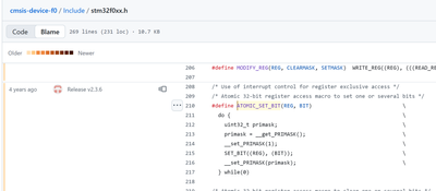

2025-10-24 7:02 AM
> In the F0 project the ATOMIC macros do not exist in stm32f0xx.h
They exist right here and have for 4 years.
Maybe you're using an outdated version. Super old project?
It's imperative that HAL/CMSIS/include files stay in sync.
