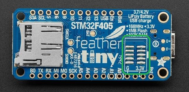

There is a clock speed of 168 MHz printed on the board that I've just changed the code and my settings to use, but I'm still not getting the output that I expect. I've attached my settings.

You need a Debugger Pod like an ST-LINK or J-LINK to connect to the SWD Debugging ports, and SWV Serial channel.
You can't manifest this via the USB DFU connection.
You'd want to attach a 10-pin debug header to the board to facilitate an SWD connection

1. Are you using an ST-LINK (or clone) which provides an external SWO pin? the most common cheap chinese knock-off ones do not, unless you physicall mod them (cut a trace, run a jumper wire from the chip to the connector).
2. If your ST-LINK support the SWO pin, did you connect the SWO pin on your board to the appropriate pin on your ST-LINK? The SWO ping is not needed for debug/programming, but SWO is required for using the SWV facilities in CubeIDE.

1. Are you using an ST-LINK (or clone) which supports SWO, the most common cheap chinese knock-off ones do not support SWO out of the box, unless you install some jumper wires.
2. Did you connect the SWO pin on your board to the appropriate pin on your ST-LINK? This is a third optional debug pin, needed specifically for SWV.
I've attached a picture of my ST-Link. It should be genuine as I bought it through ST's website, but I don't see a SWO pin on the ST-Link or my STM32F405.
