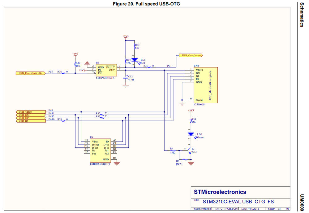

jiangfan
about STM32F105 USB/DFU, you may refer to official ST board schematics, STM3210C-EVAL/MB784. Unfortunately this board is OBSOLETE. Anyway, it may be found, so, you can refer to following schematics

FBL
Hi @Tad_E
I would add that STM32F105 is embedding internally pull up on DP. So, no need to add an external one.
Additional pins (OTG_FS_ID, OTG_FS_SOF) are not required to be connected for USB DFU to work.
