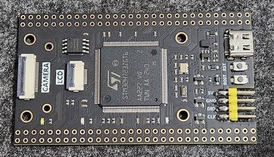

I purchased this STM32H723 mini core board that has 20 pin fpc connector for camera module and 10 pin fpc connector for LCD module.
I contacted the seller on Aliexpress and they told me this board works with OV2640/OV5640 modules, but they eventually told me that they don't have the items available.

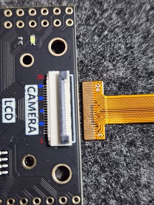

I purchased OV2640, but it turned out to have 24 pin cable.

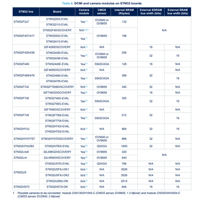

You need to contact the board's manufacturer as the connectors' pinouts are fixed. Meanwhile this is a list of camera modules that can be used in our boards (from AN5020):

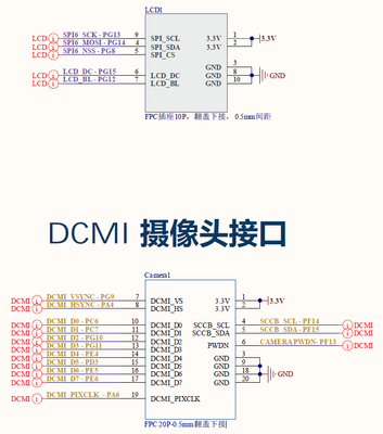

According to the schematics, you need an LCD with SPI or I2C interface but again the connectors' pinouts are fixed.

Thanks for the links, actually the board in the link you provided has the exact 24p camera interface for the camera model I have. Where the one I have has 20p.
