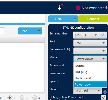

I've tried right now other modes. Normal is the one of my post, hotplug has the same errors but the current doesn't change, under reset same errors & also current drop to almost 0, finally power down doesn't react at all "No STM32 target found!" at all times.

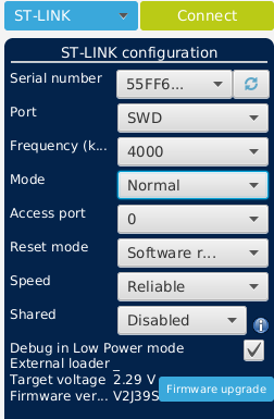

This is the ST-LINK configuration I've been using until now:
2023-02-08 3:50 AM
Disconect power from your board
connect stlink start in power down mode
click connect
plug power to board
2023-02-08 5:01 AM

2023-02-08 5:41 AM
Can you please expand on that? If I tri to connect with the board disconnected from power and then I try to "connect" with ST-LINK in power down mode I just get the message "No STM32 target found!"
