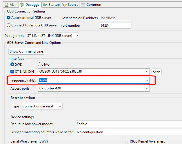

@JerryMC22 wrote:HOW I can change the frequency. In CubeIDE in menu "RUN/DebugConfiguration.../Debugger" there is no possibility to change it.
Yes, there is:
It's a drop-down list - click the down-arrow for the options:

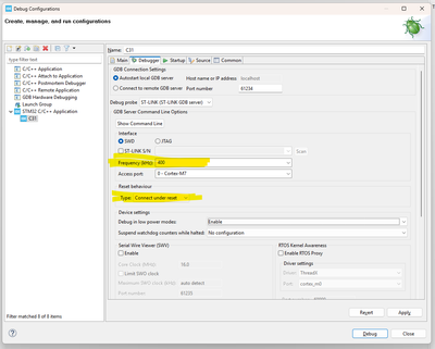

2025-01-29 1:19 AM
ok, I finally find the FRQ settings. KarlB advice helps me. Beside this I also needed to set DEBUG pins in SYS section in CubeMX - see the image in attachments. JTAG-5 pins is the best choice.
And I bought the STLINKV2 and demoboard from Aliexpress as well because of the price 16USD (345CZK). Normal genuine STLINKV2 costs approx 40USD in our country. It is too much for me.
