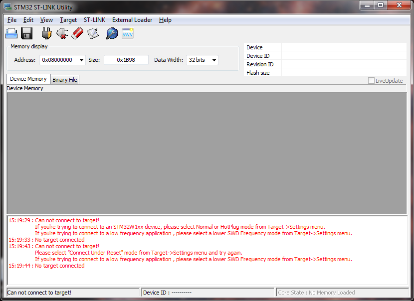

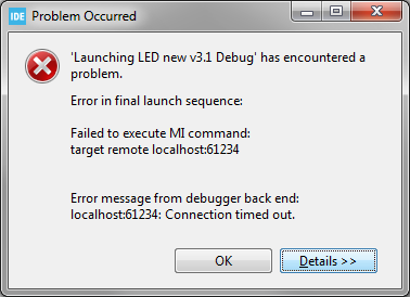

}After a power reset, I see that my program is not running and I no longer have access to the microcontroller (tried through STM32CubeIDE, STM32 ST-LINK Utility, STM32CubeProgrammer).
I have tried every possible Mode and Reset Mode.
Why is this happening? How can I regain access to my microcontroller?

Multiple threads here
The G0 is definitely not going to be supported by ST-LINK Utilities, it hasn't been updated in years now.
You'd want to be using STM32 Cube Programmer
