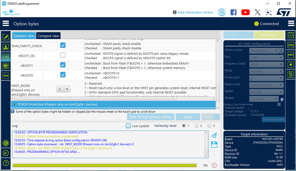

I am working on using NRST pin in stm32g031j6m6 as GPIO, but it fails every time. I've changed many option bytes and even options present only on stm32g0x1 have workwd on my chip, except of NRST_MODE. If i want to change this option to 2 (gpio mode) and try to apply, the progress bar stays at 0% endlessly until i quit the STM32CubeProgrammer. I didn't have any problems with communication between nucleo and stm32g031. I tried to program my chip with st links built in nucleo u031 and f303, everytime without success. What else can i try?

Unable to duplicate here on STM32CubeProgrammer v2.21.0.
What version of STM32CubeProgrammer are you using? If not the latest, try that.

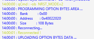

Hello there @elektronik_BP ,
Thank you for bringing this to our attention.
I have reproduced this on v2.22 and I have reported this to the dedicated team. (internal ticket number:0060237)
For now, you can switch to v2.21 as it works there and I'll let you know ASAP when this is fixed.
