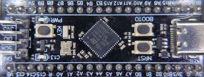

BlackPill is working properly, i can use it via DFU, but I would like to use debug.

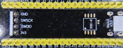

Board: WeAct BlackPill V3.0, MCU: F411CEU6 (original), SWDIO and SWCLK correctly configured on pins PA13 and PA14 (SWD configuration), target voltage 3.28V.

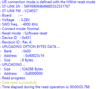

CubeProgrammer: no mode and reset mode works, tried various versions (now v2.17.0). (ST-link Utility too).

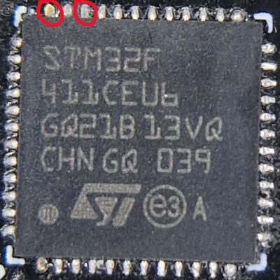

Some time ago, after checking the board, I noticed two pads not soldered correctly, coincidentally they were pin 36 (VDD) and pin 34 (PA13 of the UFQFPN48 package); but I left the hardware work as a last try, being the most risky.
Having considered all possible causes of malfunction not strictly hardware-related I decided to check this case too, trying to add solder where it was missing.
After adding it... surprise! it works flawlessly in every mode.
Seems that it was just a faulty solder, despite it being an original WeAct BlackPill.

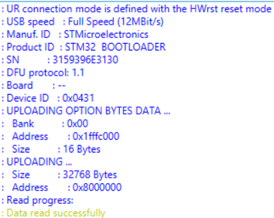

When connected via USB with DFU mode selected (BOOT0=HIGH) it's shown as "STM32 BOOTLOADER", a serial number is recognized too.

3V3 to Pin 1 (of 20-pin header)
GND to Pin 4 (or other EVEN GND pins)
SWCLK to Pin 9
SWDIO to Pin 7
Double check connectivity too PA13/PA14

As mentioned in the first post, DFU works perfectly and i can use the BlackPill in this way.
ST-link dongle works with the F303 on the NUCLEO, but the NUCLEO ST-link (in external target configuration) gives the same error with the BlackPill. This is what made me think that the problem lies in the BlackPill.
Furthermore, the power supply from ST-link works, because programs in the F411 memory starts when the ST-link power is connected, the detected target voltage is 3.28V and, if it didn't, I wouldn't have been able to program the F303RET6 on the NUCLEO.
Something prevents the F411 to be recognized by both the ST-link dongle and the NUCLEO ST-link.

2024-09-07 5:52 AM - edited 2024-09-07 5:56 AM
