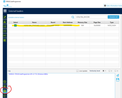

Did you setup the STM32Cube Programmer for External Loader and select the correct flash memory?

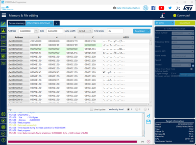

I've never done a CRC on an image or what's on device memory, do you have a perferred method that you use for situations like this? I see that there is a Verify option in the programmer. I've never used it before today. I think its comparing what is in memory vs what is in the device according to what is in documentation (STM32CubeProgrammer software description - User manual). I did a fresh download to the device and then verified. It failed. I get the feeling that I will never get the verify to 100% check out.

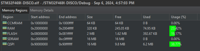

Looks like I am using internal FLASH and External QSPI:

You'll need to select an External Loader associated with the STM32F469I-DISCO to write content at 0x90000000 into the Micron N25Q128 QSPI NOR FLASH
STM32 Cube Programmer natively only supports writes into the Internal FLASH of the STM32F4
