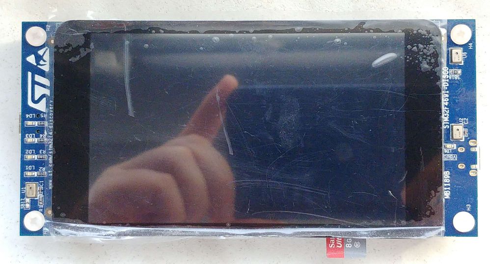

Sure:

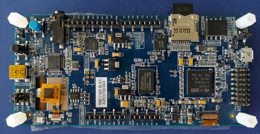

if possible, can you upload picture of other side as well ?
Sure:
So this is a revision B-03 PCB.
Assembled W37 2020.
Please use rev B schematic.
Probably the SDRAM reference has been swapped for availability reason.
