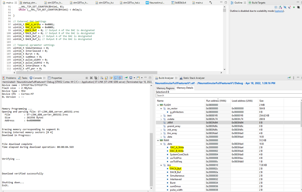

@TDK I placed multiple breakpoints at certain points (UART receive, the signal generation, and UART Transmit) on the code. In debug session, the code successfully passed from all breakpoints, and I didn't get any error messages like before. But the interesting thing is that I couldn't get the signal correctly. On the other hand, after flashing the code, I get the correct signals on my interface while the debugger was connected to the PCB.
2022-04-18 11:03 AM
@TDK One more thing is that while I was check the memory details, I saw that the variables declarations were appeared in the RAM section. I guess that this is the reason to not working the system after powered off. So how can I declare the variables to store in the flash memory?
Edit: I saw the DAC_A_Write and DAC_B_Write in the FLASH .data section. But the DACA_Buf is still not in the FLASH memory part.
