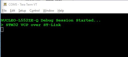

2022-04-18 2:46 PM
I can confirm now the code works flawlessly and I can debug/retarget printf output to terminal over ST-Link connection. No extra USART is required, no jumper cables, and most important from all, it's all through VCP over ST-Link connection. Previous build had an illegal access to memory. I solved it and now everything is working normally.

2022-04-18 2:46 PM
