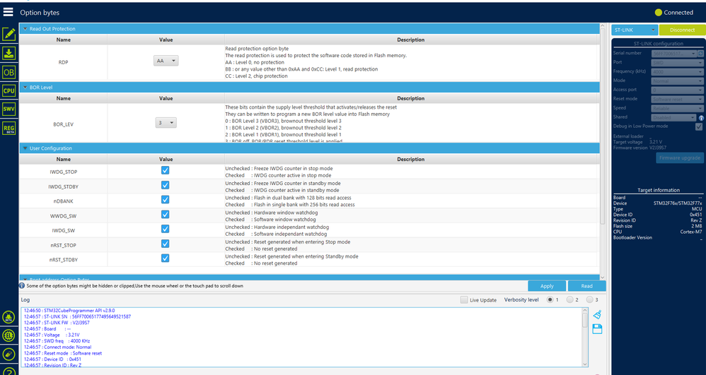

2022-04-16 6:31 AM
Use STM32CubeProgrammer to inspect them in the "OB" tab. Can also use the deprecated ST-Link Utility.

2022-04-16 10:02 AM
Thank you @Community member and @TDK !
I have attached the STM32CubeProgrammer screenshots. My impression is that all settings are correct to write the codes in the FLASH memory.

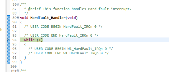

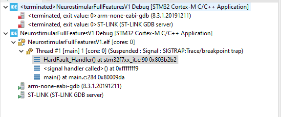

When the debugger connected and in the debug mode, the code is stuck at void HardFault_Handler(void). Attached the screenshots
2022-04-16 10:19 AM
Use the information that it's providing you. What is at main.c line 284?
2022-04-16 10:26 AM
Oh now I recognized that on the error. There is a calculation. @TDK
AmpModFreqCalculation = round((1000000 / (ModulationFreq * 128)));
So, the ModulationFreq value doesn't have a value every time. In a certain condition, the variable has value. Is it because of that?
2022-04-16 10:43 AM
Do you mean that sometimes it has a value of 0? Divide by zero can cause a hard fault. Using floating point instructions when FPU is not enabled can also cause a hard fault.
2022-04-16 10:59 AM
Yes. For testing purposes, I set the AmpModFreqCalculation as 78, and the error was gone. Thank you @TDK !
